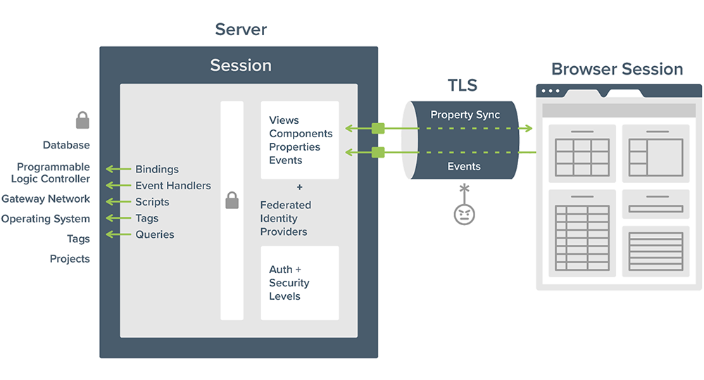

Travis: So I wanna take a deeper, closer look at how Perspective was constructed. We don't often get to go through some of the underpinnings of how Ignition is built. But I think it's very important to understand that to really get a sense of how Perspective was built with cybersecurity in mind. And this is how you can contrast this to any traditional client that communicates through the server. So with Perspective, we are simply using our browser to open the application. And we're going to a URL, an IP address or a host name of the server to get access to that. And the entire application is running there in the web browser. You're very familiar with this by going into any cloud application or web application that you may have. And you're seeing all of that, interacting with that in your browser. Of course that session though, in the browser is communicating back to that server to get information. And that's no different here for Perspective. But with Perspective, it's very limited in how it can interact with the Ignition server. So when you open up an application you built, typically the first thing you're gonna do is go and log in. You're gonna establish a session with the server, so we can verify who that person is before we can grant any access to any data.
10:24
Travis: Once we've established that session, basically, the entirety of that application is, it lives on that Ignition server, from the page that we're on to all of the components, the properties, all the events, everything that's gonna — all the models of that screen will be represented in that session. And as you can see in the diagram here, there are only two points where the actual session interacts with the Ignition server. And that is one for synchronizing properties. So if we have a tank level that is bound to a tag, we wanna make sure that as that tag changes, that we synchronize that property to the browser so that of course, we can see the proper level indicated there, or vice versa. If I were to go and write to a tag to change the set-point that we want that, we wanna let the server know that, "Hey, I've changed this particular value." And we only do that through property syncs. And it's a really important distinction here because once we synchronize that property, there's a whole layer, or sets of layers that are there to protect whether or not that can actually occur down to the device.
11:36
Travis: So there's a lot of protected things that the Ignition server is talking to, things like PLCs, or other devices, databases that it's working with, other Ignition servers through the gateway network, of course, the operating system itself, any other projects or files that may exist on there. There's a lot of things that the server is talking to, and you wanna protect those connection points as much as possible. And so we don't want to expose any of that to the actual person that is using the application in a day. And that is not how it works here. Perspective has this whole layer of security that's right in front of all those protected resources. And when you establish that session, you are doing that, and we know who that person is. And we know what levels they have. We did that through our federated identity providers, which we're gonna go into more detail here. And so as they synchronize a value, if I was to want to try to write to a tag, that has to go through this layer, to on the server check whether or not they are allowed to do that. And if not, it's rejected.
12:40
Travis: There's no way for that browser session to be able to do that. So that's one way where we can really restrict what people are allowed to do and how that interacts with the server. Second, is that there are also events that we wanna respond to. So somebody may click on a button and we want to have it do some action, or they may wanna navigate. Or of course, we may have them upload a file. We want to know that the file was uploaded and events are also sent to the server so that we can respond to those events with various handlers and maybe go off and get data or do something with that. And so these two areas are very, very low risk. And as you can see, they're going through a TLS secure tunnel, essentially, so that there's no way that a bad actor there could inspect what's going on or inject something different.
13:32
Travis: Or do something that's harmful in that way, and we're gonna talk more about TLS here in a moment. So the architecture, the way Perspective was built, really we thought about security from the very, very beginning. And the most important thing is to protect these resources over here so that there's no way for a bad actor to be able to get access to that without going through these really secure layers and having the verifications that are in place.
