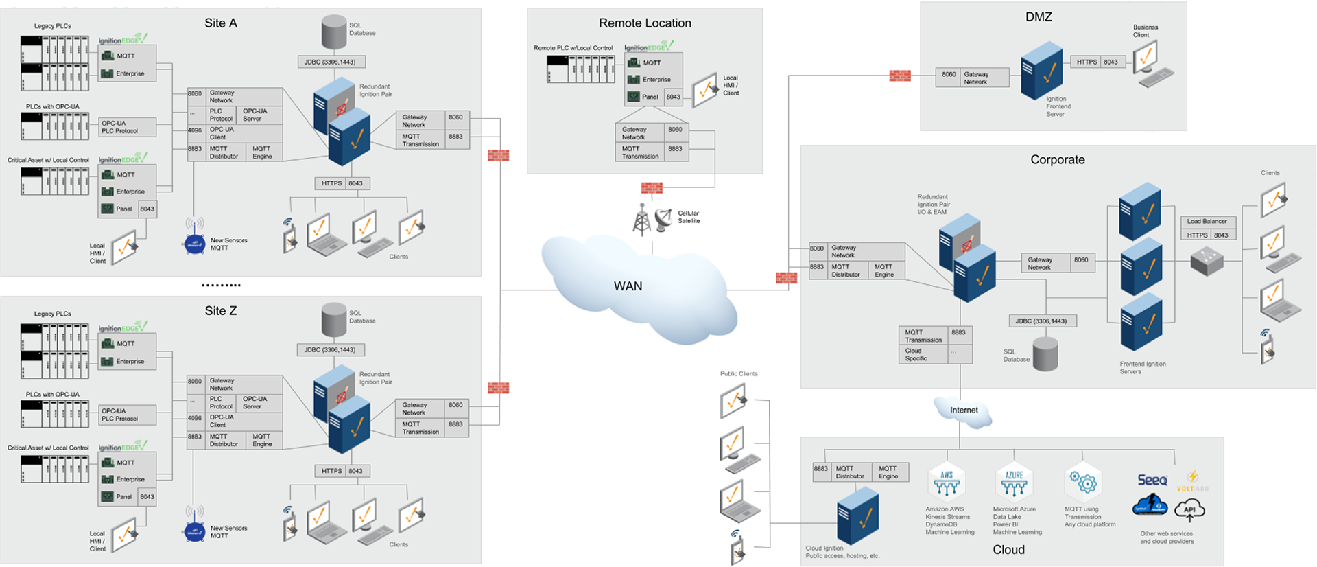

Phase 2: Project Architecture
Alright, once we've asked ourselves all those types of important questions and we've answered them, we can move on to phase two. Or at least, we have a plan of how we're going to answer those questions. Phase two is all about breaking down your architecture to different components, visualizing how they all work together, making inventories of the necessary functions, screens, data points, and organizing everything in a consistent way. And I want to give you some bit of tips on that here today. So again, coming back to the architecture, you can see all the different components in there. Now, we talked about some of the important questions you have to ask, but what does that look like in terms of actual details? How do you choose levels? How can we fit all this together? And hopefully, I can give you an idea of that through just some tips.
Architecture Tip 1: Protect Legacy PLCs by Adding Edge Devices
Tip number one is basically protecting legacy PLCs by adding edge devices. As we all know, legacy PLCs, with their poll-response protocols, they are inherently insecure, in that, if they're on a network and somebody knew an IP address and knew the protocol that was underlying that PLC, they could do some harm. So it's our responsibility to protect those PLCs, and we often do that by air gap systems or by putting firewalls in place and whatnot, but there are so many attack vectors that we really have to try and limit this as much as possible. And a great way to do that, at least from my opinion, is to have edge gateways.
architecture
As you can see in this diagram, look over here in the sites with these legacy PLCs, we could put an edge device and there's different options out there, hardware and software-based. In this particular case, I'm showing Ignition Edge, but it can talk to that PLC locally. So literally, the PLC's only connected through ethernet to the edge gateway, and the edge gateway can then bring that information up to a central system through a much better protocol, such as MQTT. We're going to talk more about that in a moment. And then, when you look at getting new PLCs that would either support MQTT or OPC UA, then they'll just be an inherent part of that network, and there's already security built into that, and that was thought of from the beginning. So we're talking about the legacy ones that have those potential attack vectors. We want to minimize those as much as possible.
Architecture Tip 2: Utilize the MQTT Protocol
Number two is to utilize the MQTT protocol. And I know a lot of you may not know what MQTT is. We, of course, do a lot of presentations and webinars on this subject. We really think this is the way to go for true enterprise systems. It is a machine-to-machine data transfer protocol and it's quickly becoming the de-facto standard or the leading messaging protocol for IoT. I thought I'd just briefly touch upon that. The idea is that we will decouple our application from our devices. Instead of having a SCADA system talk directly to the PLC and pull that PLC, we're going to have the PLCs publishing the information up to a broker, to a central system, message-oriented middleware, that then many applications could subscribe to and get information from in a true way. Very similar to what's done in the IT space with messaging buses, enterprise service buses, we're doing that for the actual industrial data that we're dealing with.
And why should we use it? A lot of reasons. Decoupling is an important one. We can have SCADA decouple from the devices, so that SCADA can only use what they require to maintain that operation, maintaining that functionality. Why? Then the business can get data from it without affecting the operations piece, and the fact that we could have multiple applications getting access to that data. It was designed for low bandwidth. It was actually designed for oil and gas when we're moving data through satellite, so it's a report by exception, only data is being pushed when things change and it's very small. The payload or the actual header is two bytes and rest of the payload, the payload is very much designed to be as small as possible, and you would see that with looking over the wire.
It has TLS security and Access Control Lists, so security is an important or an inherent part of the protocol, so that if we're putting that in front of the PLC, we then now have taken a legacy poll response protocol and moved it into a secure channel that we can then deliver to places, and in fact, deliver to the cloud as well. If you're talking about actually leveraging the cloud and getting real data to the cloud, MQTT is really the only way to go that's the most effective way of streaming real-time data in a secure way. And it's outbound connections only. I'll talk about this again a little bit later, but this is really important, in that the connection's made from the local level, the plant floor or the asset level up, there's no need for firewalls coming down, especially if you're going to deliver information to the enterprise, I do not have to have any firewalls, any ports open of that firewall locally, it's only going out. But of course, it does allow us to do reading and writing.
Stateful awareness, so we can know the state of the connection to the PLC, that is extremely important for control systems. And the devices, the edge gateways, the sensors, they become the single source of truth that everybody is going to be looking at, and it delivers that information that we need. And it's very plug-and-play, because I can plug a new device in, it can publish data to a broker, it can automatically be discovered by applications, and we can start using it in a very simple way. So as you can see, this is an open standard that allows us to... We can get our legacy converged over to it as well as getting new information coming in, that is thought about as one unit that allows us to effectively deliver data to our enterprise. And one important point I wanted to make about MQTT is that the reason this is all possible is because of the actual payload specification called Sparkplug.
I don't want to go into too much detail, but you think of HTTP, that protocol. HTML, it was the actual definition of the data being transferred over HTTP, and that has opened up, unlocked a lot of potential in the web world. We're talking about MQTT with Sparkplug, being that for MQTT for mission-critical, real-time environments, for control systems that importantly have all the metrics and metadata that we need from that tag, identifying what that tag is, where it comes from, what the engineering units are, what lows and highs are, that we can then deliver it to applications. So it has context, it has state, and we can use it for these kinds of systems.
Okay, so where is that being utilized? As you could see here, we're utilizing it in a lot of places in the diagram. It's a little bit small, I realize, but these edge gateways here, talking MQTT, bringing that to a system at the plant. The plant can be sending data through MQTT to our corporate. Corporate could be sending data through MQTT to the cloud. Remote locations can certainly send data through MQTT. We've been utilizing that everywhere, whether it's planned for or whether it's getting information over the WAN, now we can do that very effectively, and leveraging all that real-time data in different places, and different applications that we want to work with. That's where we're using it here on this diagram.
Architecture Tip 3: Maintain Local Functionality But Still Have a Connected System
Tip number three is, maintaining local functionality, but still having a connected system. And this is obviously important in control systems, this is something we do a lot, where we have a critical machine that has a local HMI on it. So that it's not relying on the connection to a central plant server or relying on a connection to a corporate server, it has functionality. In this particular case, I'm showing you an Ignition Edge panel which is local HMI. But also, with the MQTT, there's some store and forward of data on that local level. I can cache the information and forward it to the plant or to the corporate location when the connection is back up again. So we can really handle that loss of communication, not only at a plant level, but more importantly too, at a remote location. And that remote location, it could be over cellular or satellite or poor connections. The report by exception is really important, but also to maintain that local functionality at that remote location.
So we all have to deploy some sort of software there, but we want to make sure that the software we're deploying locally not only can deliver information in an effective way, but allows us to have that project there that is not a complete island or gap in the system, that we can manage that centrally, and that we can update that easily, and that we can make changes to it, whatever. We need to have a local functionality, but it can't be thought of as this thing that's forgotten. It has to be maintained, it has to be worked with, it has to be connected to enterprise. And when you look at software, that has to be an important part of it.
Architecture Tip 4: Use Redundant Hardware and/or Software
Tip number four is to use redundant hardware and/or software. I talked about this before. You'll notice in this diagram, I have redundancy at the site level, also potentially at the corporate level there. I didn't show it in terms of these edge gateways, just because I was trying to talk more about the protocols, but this is where I was getting at, is that oftentimes, redundancy is done at higher levels and forgotten about at lower levels, especially with legacy PLC, if you put an edge gateway in there, unless it has some hardware redundancy or built for ruggedized use, you may want to think about having some sort of redundancy, but obviously where it makes sense. So I always look at every system in terms of, "Do I need to have this there?" Ask myself, "What would happen if this machine was to fail? Is that going to be an issue for the enterprise?" If I can't lose any of that data, and I have to have something right there all the time and automatic failovers, then the answer is, "We've got to have redundancy." I know there's more cost to that, depending on hardware and software that you use, but you need to have a reliable system too, going forward.
Architecture Tip 5: Know How to Deal with Poor Connections; Use Bandwidth Efficiently
Tip number five is knowing how to deal with poor connections, and using the bandwidth efficiently. And that's, again, with this remote location, being able to utilize something that can store and forward data and do that effectively over that connection, that has bandwidth considerations built into it. MQTT just really, certainly, takes the cake for that. It makes it very easy in sending the data over there. And even OPC UA, to some extent, does have a lot of that as well, so we can get data up in different ways. We just want to make sure that we're able to leverage a better protocol so that we can not only get data faster, but that we can get access to more of that data at that remote location, because if we have restrained bandwidth, I want to make sure I can utilize it to send more data rather than a small amount. I want to get access to that 90% of that data that's stranded out there.
Architecture Tip 6: Have a Management Plan; Choose Software with Management Capabilities
Tip number six is to have a management plan in place, choosing software that comes with these management capabilities. And this is extremely important when it comes to software, and even, in some cases, hardware and patching and all of that, you want to have a central way of doing that. You look at companies like Moxa and companies like Hilscher and Opto 22 and many, many others. I'm leaving out a lot of those there. There's a lot of other companies who not only are deploying these hardware solutions out there but have software to manage those hardware solutions from a central location. So that's important when you're looking at choosing hardware. Choosing peer software, like a SCADA system, you also have to have that same functionality. And I know I'm biased here, I'm talking about Ignition, but Ignition has what's called enterprise administration, and so not only can I connect all these systems, all these Ignition servers together in our network, and that they can also be connected through the Purdue model through proxies in the middle and then having DMZs, all of that, but we can connect them all together, and when we do that, we can check the health of all these servers.
So here, centrally, I can check the health of everything that I've got, I can do remote diagnostics, I can centrally do licensing, I can take backups for disaster recovery, I can centrally upgrade those Ignition servers that are everywhere, as well as I can take a project that was developed at a corporate level and make changes to it and deploy that to every place in the architecture. And so that just becomes an important part of this that, the more you connect the enterprise, the easier it has to be for management and for updating them, for patching them, for all the stuff that we know we have to do. And certificate management, these are the new challenges that are introduced when having distributed architecture. Before, it was just a simple server out there, it was never connected. We might export data to CSV and do something with it, but as soon as you create real-time connections, you've got a lot more to consider.
Architecture Tip 7: Use Layers to Keep Networks Secure (Purdue Model)
Alright, tip number seven is using layers to keep networks secure, and we're seeing this a lot more now with networks that are using the Purdue model. Again, that's a DMZ that I was referring to kind of over here. Oftentimes, this in the middle, like a layer 3 for the plant floor, layer 4 for ERP, for business, and in the middle is a 3.5, and you want to be able to use that. Now, you have to have software that can work in that way with proxies, or sending data through that that allow us to work with it efficiently, but using these can allow these systems to be connected in a secure way where we can remove that layer if there was some attack or some risk that was identified. And that comes down to security as well, and security is incredibly important, as we're going to talk more about. You’ve got to think about every level, everywhere you are, and there's a lot of best practices involved with that.
Architecture Tip 8: Have Scalability at the Corporate Level
But also, tip number eight here is, have scalability at different levels and, very importantly, at the corporate level. And that's something like over here, I'm showing a diagram of the corporate where, if I'm taking a lot of data from multiple locations, remote locations or plants, I’ve got to be able to handle that amount of data and store it efficiently in one or more databases or data lakes or whatever it happens to be. So having the ability to scale out IO and scale up the management, also scale out front-end servers using things like load balancers to get access to that data from multiple people who want to access it … We're just getting into bigger systems, and when you get into bigger systems and more demand on who wants to look at it, we've got to be able have scalability on the software and on the hardware fronts so that it can work effectively and to be able to utilize databases or data lakes in a much better way.
Architecture Tip 9: Have a Plan for the Cloud
Which brings me to having a plan for the cloud, and this is incredibly important because everybody wants to leverage cloud, they think of machine learning, business intelligence analytics as those buzzwords they want to go into, but they don't know how to actually approach it, what they're going to be doing with that. And so, once you identify the problems in the case, what you're trying to solve, then you can start looking at the different cloud platforms, what they have, and figure out how we're going to get data to the cloud efficiently.
And when you look at something like AWS or Azure in particular, IBM IoT and their cloud platform or Google Cloud, at Ignition, we have direct injectors to put data direct, stream real-time data with that metadata to those systems, so that we can take advantage of all of their tools. But once we stream it to them, they’ve got to go into their cloud platforms to figure out how to utilize that efficiently and work with it in there. So it's not just enough to say we can stream it, we got to do something with it too. You have to have people who can actually turn that into real reports and information up there. And we also see, sometimes, bringing Ignition servers or software, HMI/SCADA software, to the cloud, not for control but for central visibility of data, or reporting, those kinds of things as well. So again, having a plan, knowing how we're going to deliver information to it efficiently, whether it's using MQTT, or whether it's using web services like REST or SOAP-based APIs, understanding those are half the battle.
