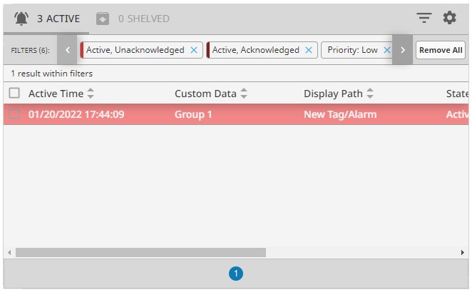

For some time now, we’ve had associated data attached to alarms which enables users to add a custom property to alarm events. This lets developers capture specific defined data when an alarm is triggered and store that alarm event and its associated data.
In 8.1.14, you can now display the associated data within the Alarm Journal Table (AJT) and the Alarm Status Table (AST). Just add an additional column within the properties that displays the associated data with its related alarm event. This is something that was not possible before.
The “Custom Data” column is showing values for associated data on the alarm.
While we’re on the subject of columns, within the AJT and AST, you can now drag and reorder the columns during the runtime.
