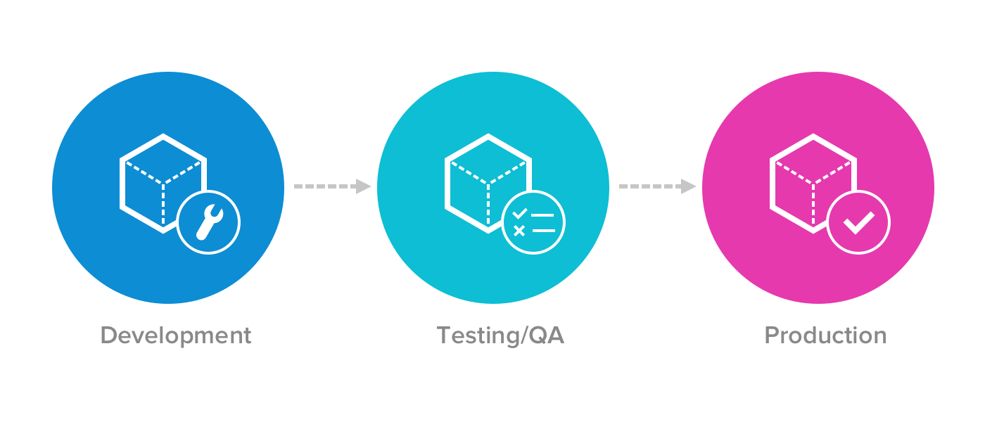

Deployments should be treated as part of a development workflow, not as an afterthought. Your workflow will usually include at least three environments: Development, Testing, and Production. In that case, the workflow might look like this:
  1. Developers work on bugs and features in a development environment.
  2. Once features are implemented, they are merged into the testing branch and deployed to the testing environment for quality assurance and testing.
  3. After testing is complete, the development branch is merged into production and then deployed to the Production environment.

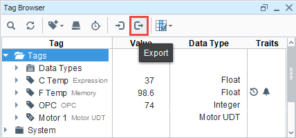

Ignition can export and import Tag configurations to and from the JSON (JavaScript Object Notation) file format. You can import XML (Extensible Markup Language) or CSV (Comma Separated Value) file formats as well, but Ignition will convert them to JSON format.
Tag Browser
Tags can also be moved through Ignition’s EAM Module from Gateway to Gateway. Tags are much easier to work with when deploying changes. However, tags are still stored inside of Ignition’s internal SQLite database and steps must be taken to track changes of tags.
We recommend continuously exporting tags to a JSON file and committing the file to a source control repository to track changes. The process of exporting tags can be done automatically using a Python script in Ignition (more information to follow). You can either use Ignition’s EAM Module to deploy changes from development to testing to production or manually export/import through the Ignition Designer.

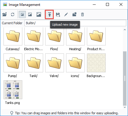

Images such as PNGs, JPGs, GIFs, and SVGs can be uploaded in the Image Management Tool and used inside of Vision or Perspective. The Image Management tool, available from the Tools > Image Management in the Ignition Designer, provides an interface to upload, download, or select images.
Image Management
These images are stored inside of Ignition’s internal SQLite database and are not part of an Ignition Project. Rather projects simply reference images.
Images cannot be moved through Ignition’s EAM Module from Gateway to Gateway. The process is manual and requires using the Image Management tool in the Ignition Designer. Steps must be also taken to track changes of images.
We recommend continuously exporting images to a folder and committing the folder to a source control repository to track changes. This process cannot be done automatically and requires manual intervention. You have to export/import images through the Ignition Designer when deploying changes from development to testing to production.

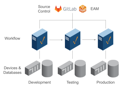

Deployment Environments
Environments
Development
The development environment (dev) is the environment in which active Ignition development is occurring. This environment is the first step of the workflow. Here developers are working on bug fixes and new features before introducing them to the production environment. It is very handy to have a separate branch in your source control system called development to represent your development environment.

Testing
Once the features are implemented and considered fairly stable, they get merged into the testing branch and then deployed to the testing environment. This is when quality assurance kicks in: testers go to testing servers and verify that the project works as intended.
It is very handy to have a separate branch in your source control system called testing to represent your testing environment. It will allow developers to deploy multiple branches to the same server simultaneously, simply by merging everything that needs to be deployed to the testing branch. It will also help testers understand what exactly is on testing servers at the moment, just by looking inside the testing branch.
Production
Once the feature is implemented and tested, it can be deployed to production. The production environment is also known as live, particularly for servers, as it is the environment that users directly interact with.
We recommend always deploying major releases to production at a scheduled time, of which the whole team is aware.

    We have now successfully committed our projects. We also need to export and commit tags, images, and Gateway configuration. For tags, we can export the tags from the Designer into a tags.json file. For images, we can use the Image Management Tool in the Designer to export all images to a folder called “images”. For Gateway configuration, simply make a Gateway backup. Take all files and folders and store them into the projects directory. Once added, use the following commands to commit them to the repository:
    NOW=$(date +"%m-%d-%Y %H:%M:%S")
    git add .
    git commit -m "Designer save @ $NOW"
    git push origin
    Adjust the script above for Windows. Everything is now saved to the repository.

    2. Deploying Tags
      The tags.json export file will get pulled from the previous step. You can either manually import the tags into testing or use EAM to deploy tag changes.
    3. Deploying Images
      The images will get pulled from the repository from the previous step. You will have to manually import the images into the Image Management Tool in the Ignition Designer.
