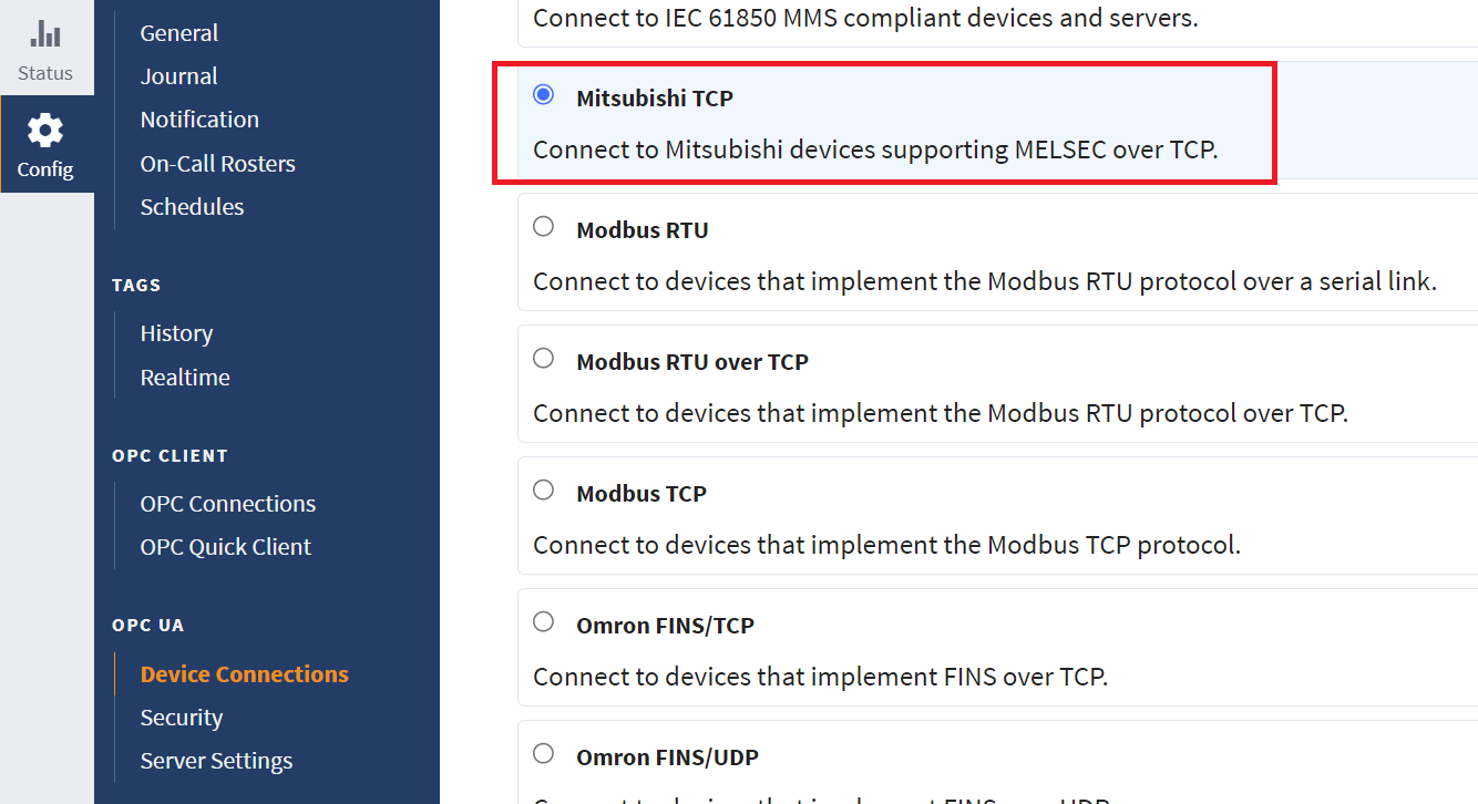

Mitsubishi Driver
The Mitsubishi driver is here! 8.1.28 adds support for MELSEC over TCP with the following hardware series: iQ-R, iQ-F (FX5U), Q, and L. Given the popularity of MELSEC PLCs across the world, it’s an understatement to say that a large portion of the Ignition community will be thrilled to have this compatibility built into the platform. Connecting to Mitsubishi devices is now as simple as heading to the Gateway Config page and selecting Mitsubishi TCP from the Device Connections menu.
Mitsubishi Driver
Similar to the Modbus and Omron FINS drivers, the Mitsubishi driver provides manual addressing syntax for reaching out to specific Device items on PLCs. There is also an optional address-mapping configuration that supports the import/export of browsable addresses using the CSV format.
This driver has been highly requested for a while now and we’re excited it has made its way into the Ignition platform. But this is just a starting point, so watch this space for future updates.

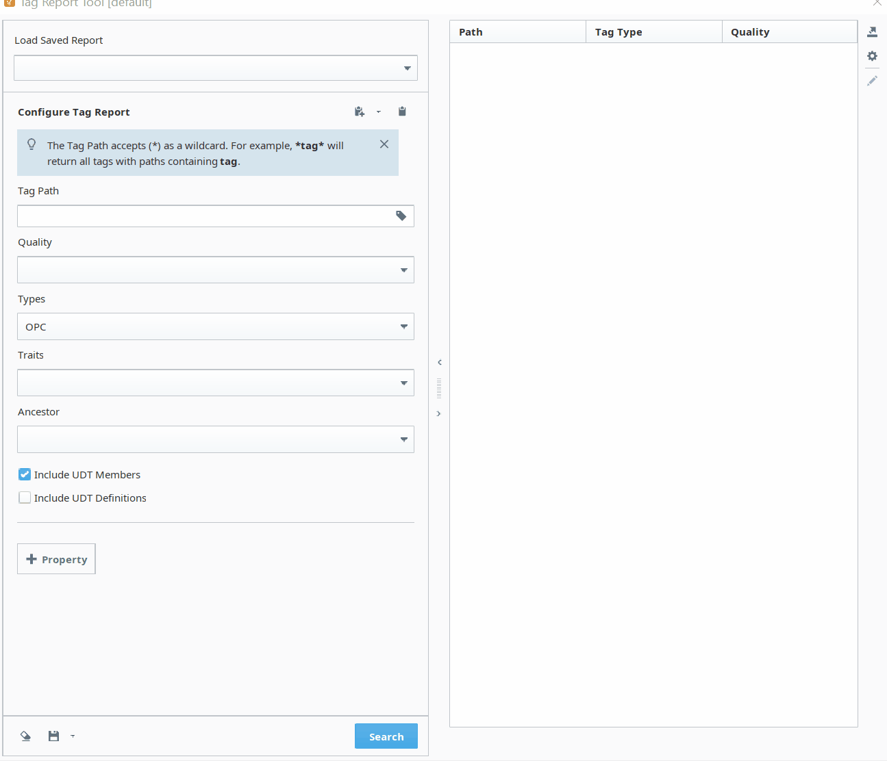

It’s easy to get lost in tag town; there are thousands if not millions of tags here. Luckily, Ignition 8.1.28 adds support for “OR” searches in the Tag Report Tool.
To make a long story short, the Tag Report Tool lets you ​​quickly build queries to search for specific tags based on chosen properties like tag path, quality, types, and more. In prior versions, the Tag Report Tool only supported “AND” if you were searching by multiple groups, meaning the results would only show tags that met all criteria. The only method for creating an “OR” search — one that showed tags that met at least one criteria — was through scripting.
Now, 8.1.28 supports “OR” grouping in the Tag Report Tool UI itself, finally bridging the perilous "and/or" divide.

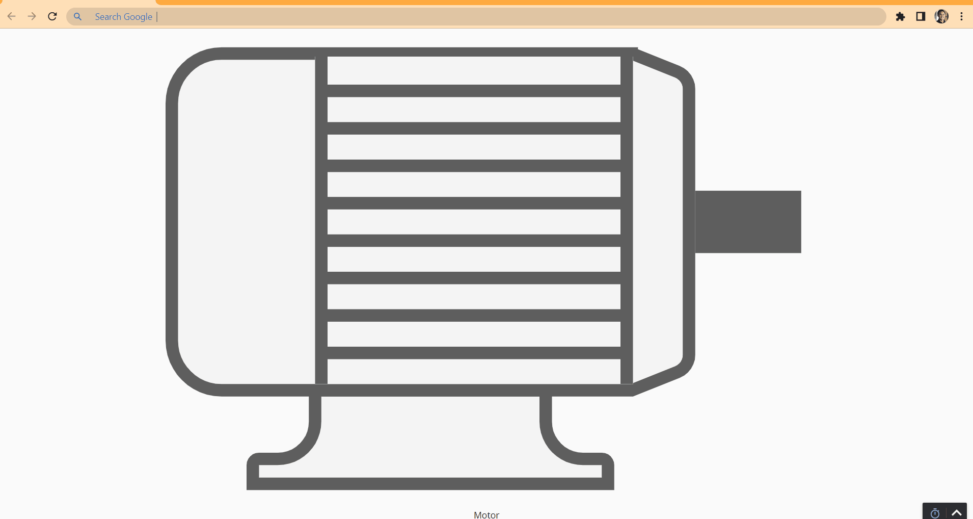

8.1.28 adds the “Request Print” component action and “requestPrint” script-callable component method, both of which allow you to print a page, view, or component. As with most things in Ignition, these print actions can be customized based on when you want the event to occur.
Request Print
So whether you need to pull an entire view out of the digital realm and into physical space or you simply want to frame a pristine Motor Component to have on your desk next to that family portrait, now you can.
Print That Motor

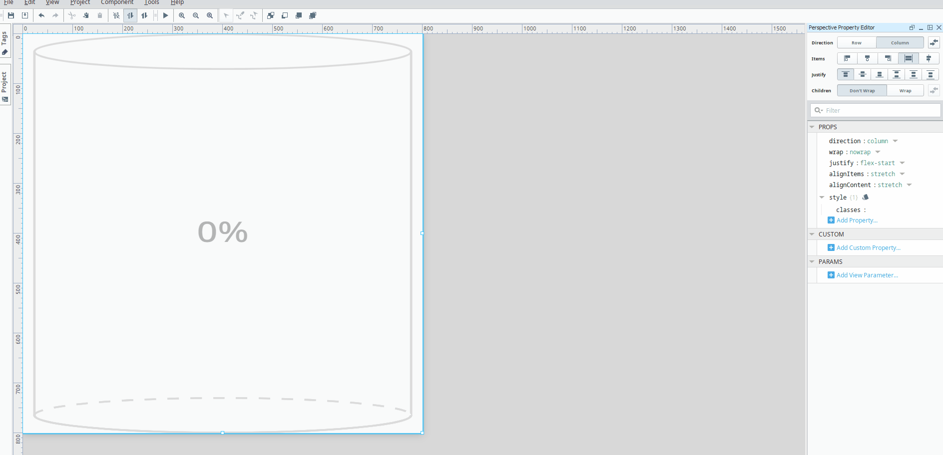

CSS backgroundSize
8.1.28 adds a free-form text field for the CSS backgroundSize property in the advanced section of Perspective’s Style Editor. This property customizes how images fit the background of a component or view, whether that means a repeating pattern, a complete cover, or an image contained within a particular boundary.
Background Size
Chromium
The final Perspective update gets under the proverbial hood, upgrading JxBrowser framework to Chromium 108.0.5359.215 for the Perspective Designer workspace and the Vision Web Browser Module. This does not apply to Perspective Workstation as of 8.1.28, but that is coming soon.

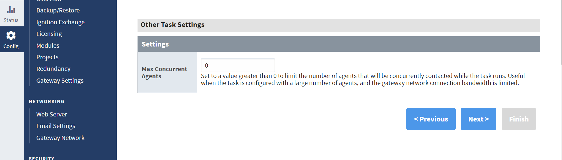

  • Added the Max Concurrent Agents setting to the Send Project EAM and Send Project Resources EAM tasks. Previously, long-running EAM tasks would fail if the task data was in a pending transfer queue for longer than the hard-coded 60 seconds. The Max Concurrent Agents setting lets you divide and conquer, specifying the numbers of agents the controller contacts at once, and transferring data one group at a time.

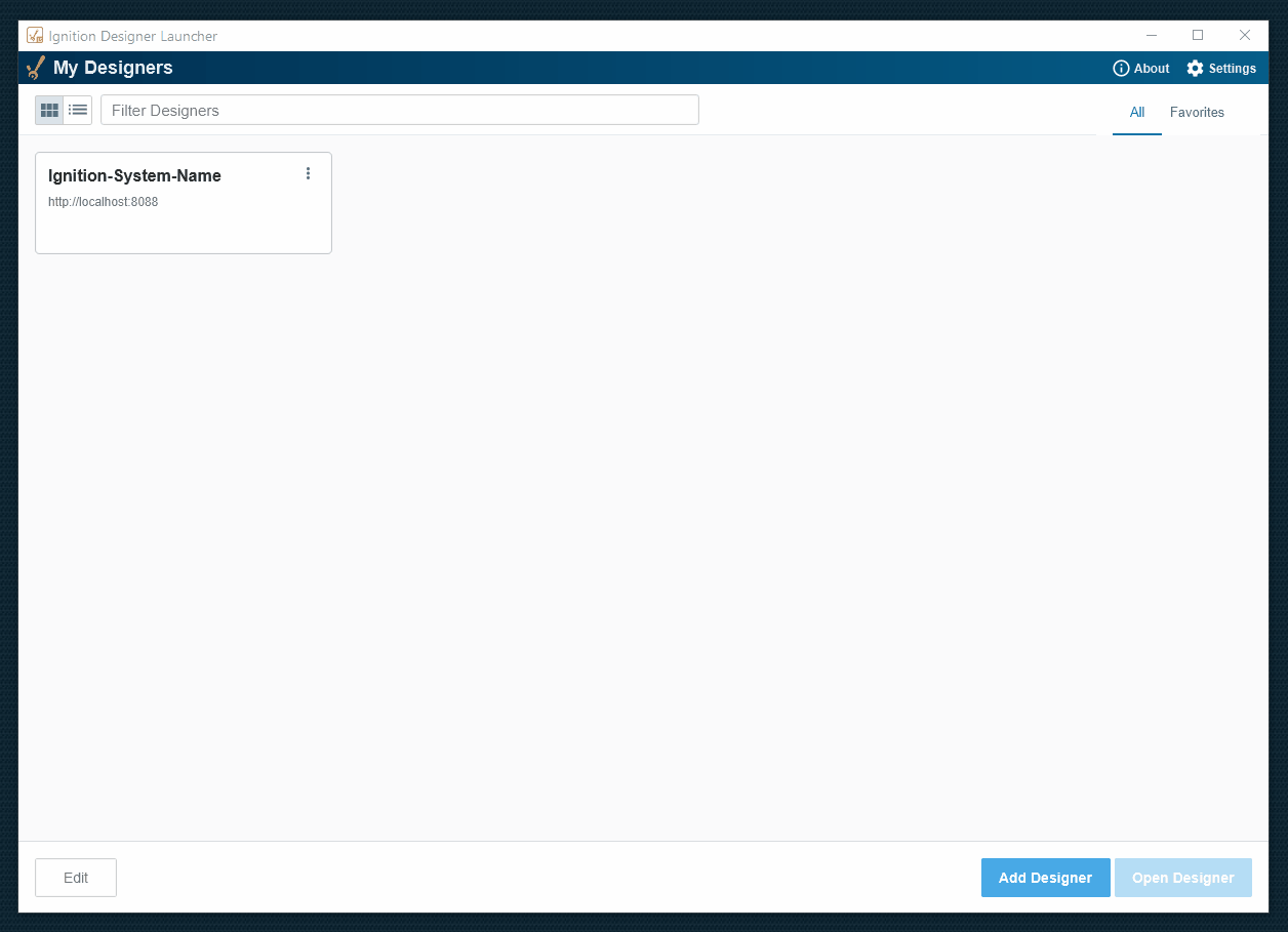

  • Added persistence to your selected launcher view preference. Your last selected preference — card or list — will save to the launcher’s JSON across restarts. Saved you a click!

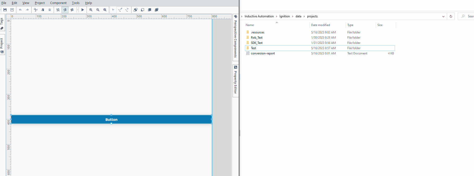

  • Added the system.project.requestScan function and an SDK-accessible method to scan the project directory itself for any manual changes made on the files and folders.
Project Scan

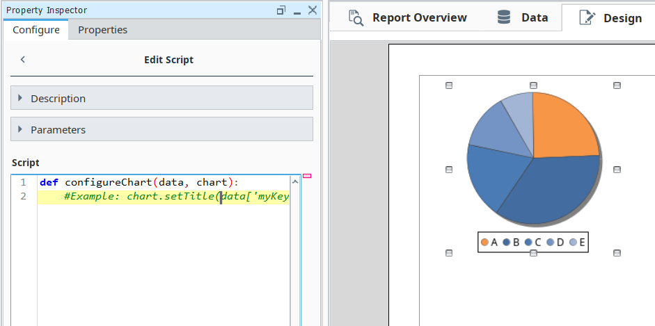

  • Added "configureChart" scripting function to a report’s Pie Chart, enabling you to modify the chart prior to rendering.

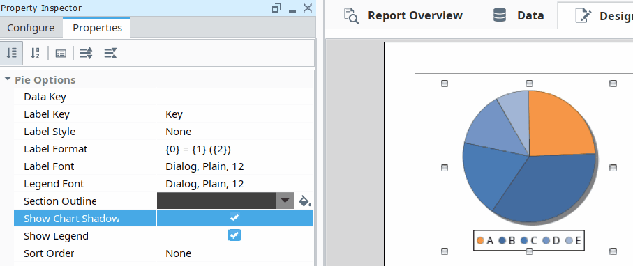

  • Added "Show Chart Shadow" property to a report’s Pie Chart to toggle the background shadow.
Pie Chart Shadow
