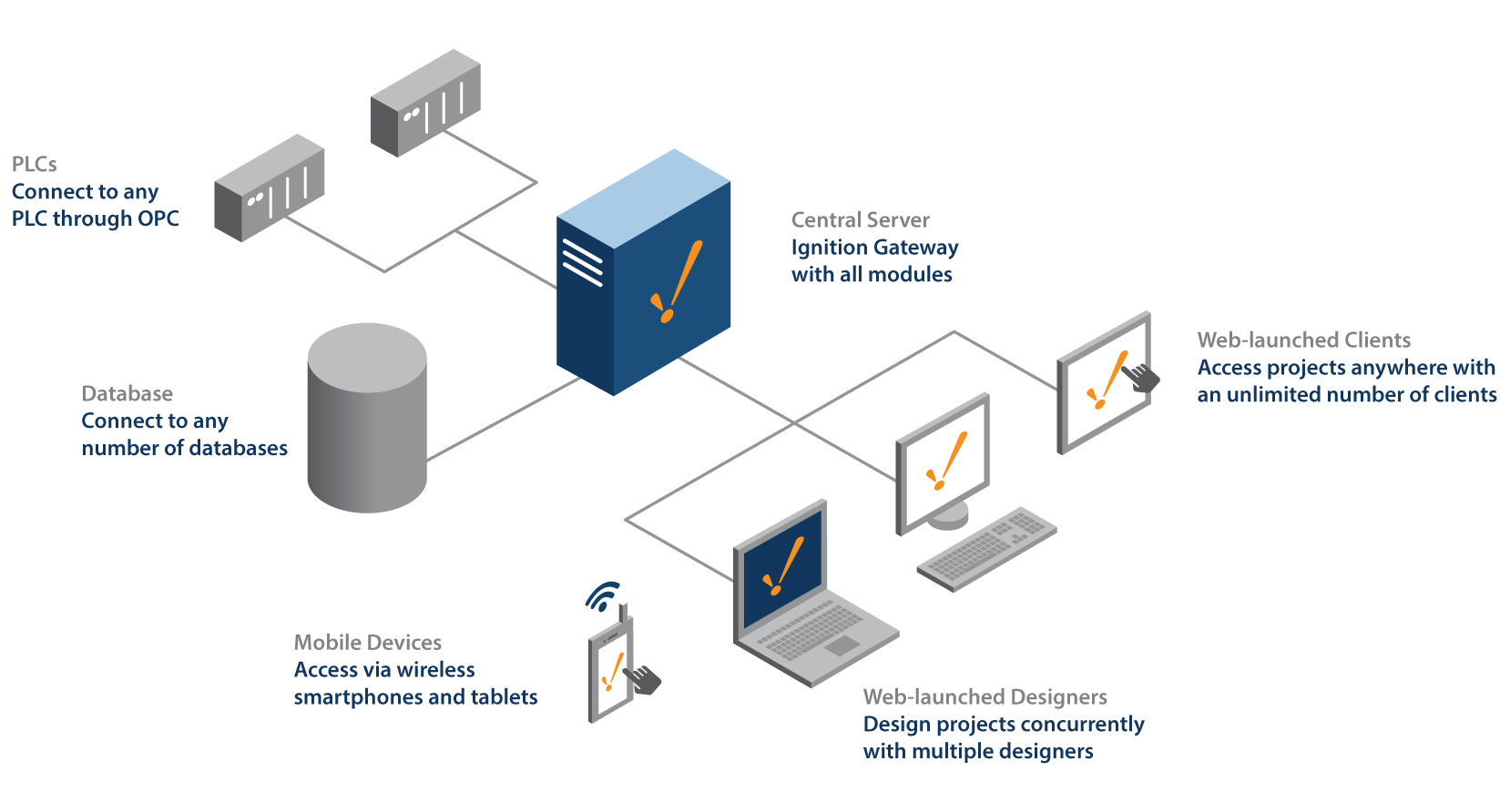

Single Ignition Server
* This combination of modules is bundled together in The Works package.
The standard Ignition architecture is a single Ignition server installed at a single site. This single-server/ single-site deployment, in which Ignition and all components are all installed on a single machine, is the one that most Ignition users begin with.
The modules typically used in the standard architecture are Vision, SQL Bridge, Reporting, Symbol Factory, and Alarm Notification.* With that platform, the user can connect to all of their PLCs and databases, do realtime status control, alarming, use pre-made vector graphics, create professional reports, display optimized HMI screens, and more – all on the same machine.
It’s a beautifully simple setup: for the price of one server license, the user has one place for all of their SCADA installation, configuration, and backup, for an entire facility. If you have one site, then one server can provide all the functionality you need.
However, with only one server there is a single point of failure. It’s best to set up a redundant pair of servers so that if the master server fails, the backup server will take over. Doing this will make your system fault-tolerant.

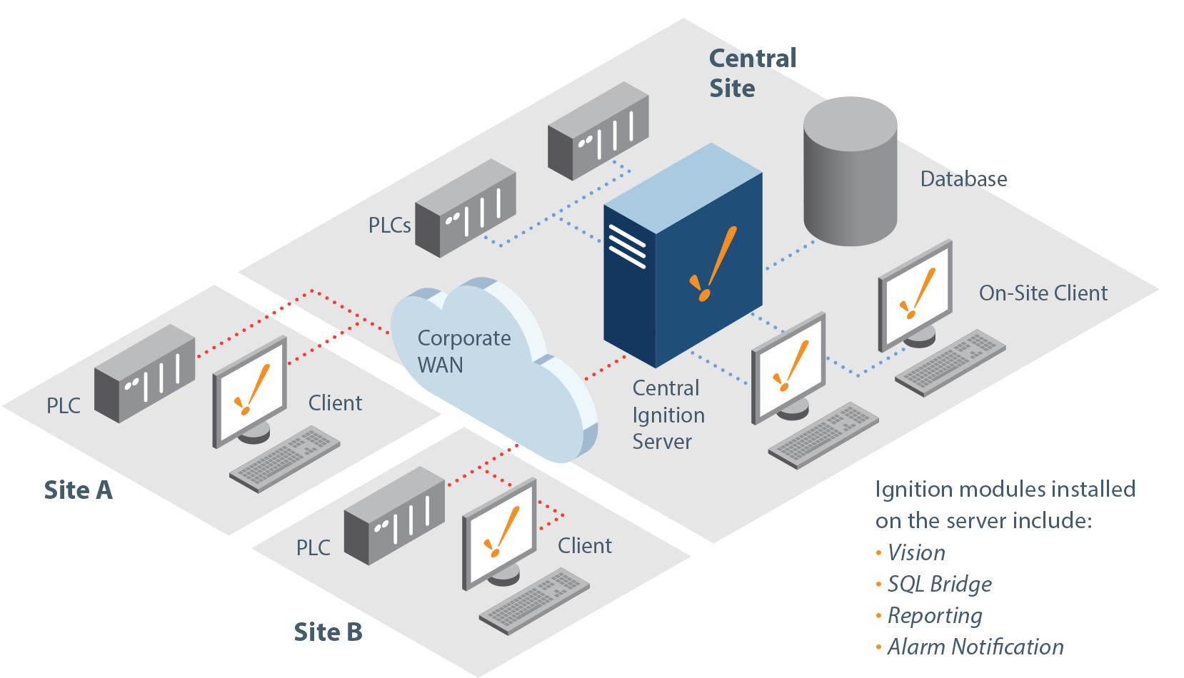

A single Ignition server can also be used for multiple sites. For example, if your organization installed Ignition at its central site and then wanted to view and control two remote sites in other parts of the country, you could connect all three sites through a corporate wide-area network (WAN). With one Ignition server connected to the PLCs at the remote sites over the WAN, you could collect information from all PLCs to one database at the central site. This is quite attractive from a cost perspective because you could collect data from three sites on one license.
However, there is a drawback to using one Ignition server for multiple sites: if the corporate WAN goes down and causes the central server to lose connection to the remote sites, the remote sites will lose historical data and visualization. So if access to historical data and visualization at the remote sites has to be maintained at all times, it is recommended that you use an architecture with more than one Ignition server.
Ignition Standard Architecture: Multiple Sites
Central site collects information from other sites.

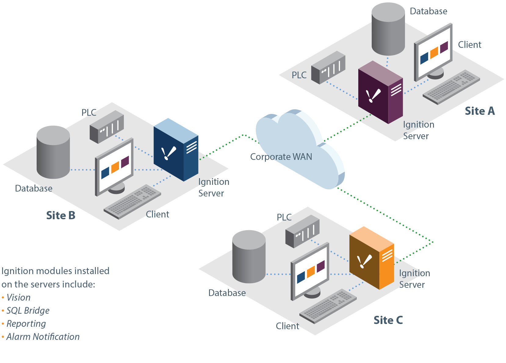

You could deploy a variety of Ignition architectures that use multiple servers at multiple sites. The most basic of these is the Wide-Area SCADA architecture. An organization using Wide-Area SCADA at three sites would have one Ignition server at each site: all three servers would be connected through a corporate WAN, and all three would have the same modules installed so that the full functionality of the Ignition application would be available at each site.
From the perspective of an operator, Ignition would appear as if it were a single, cohesive application even though it is actually distributed across three sites. Through a method called client retargeting, the operator could quickly switch from a project on an Ignition server to another project on another Ignition server. This would make managing different projects at geographically dispersed sites much simpler than it used to be.
Wide-Area SCADA
Wide-Area SCADA
Switch from one project on one Ignition server to another project on a different Ignition server.

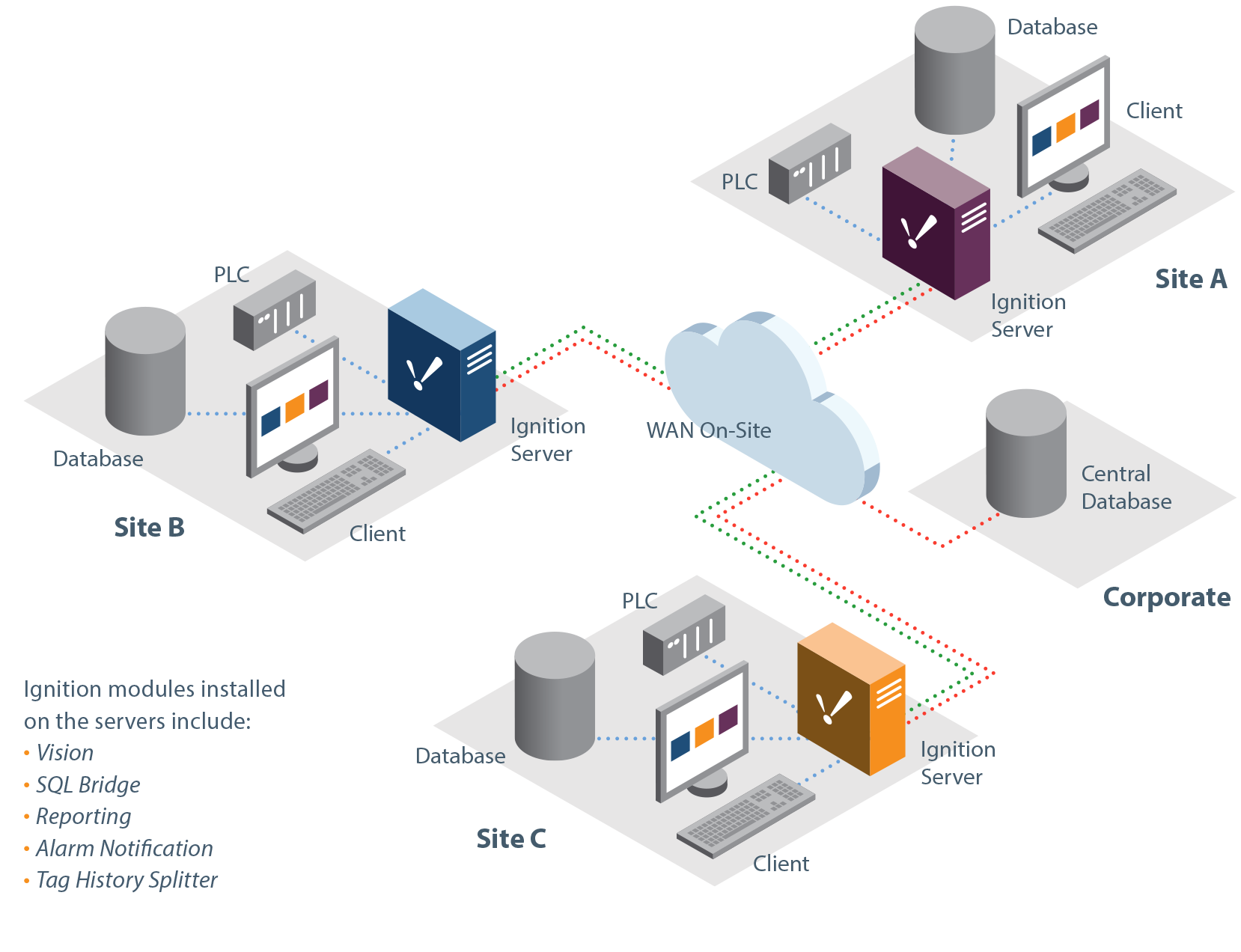

But what if at some point your organization decided it should start analyzing data across sites? That would require that data be logged not only locally but centrally. In this case, you’d be advised to use a variation of the Wide-Area SCADA architecture that includes a central database where all three Ignition servers could log data. Data can be logged to both central and local databases by adding the Tag History Splitter Module. This setup would give you the ability to get more insight from your data by comparing sites to each other on the same trend, or aggregating the data from all of the databases into one report.
Wide Area SCADA-Central Database
Central database could be at any site.

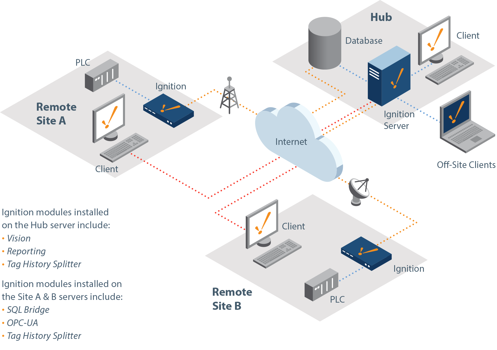

Organizations that have a very large number of remote sites, such as oil-and-gas companies that operate hundreds of rigs out in the field, need a reliable and economical means of logging their remote data. Hub-and-spoke is a type of multiple-server architecture that is ideal for organizations with hundreds or thousands of remote sites, because it allows them to collect historical information from many remote sites to a central location, while keeping costs down by using a minimal number of modules at each site.
The hub in the hub-and-spoke architecture is the central site with an Ignition server that has the Vision and Reporting modules. The spokes are the remote sites, which each have a data-logging computer with Ignition and only the SQL Bridge and OPC-UA modules. That way, the remote site connects to the PLC locally so that data will not be lost when the connection to the central hub goes down. The Ignition store-and-forward feature on the embedded data-logging computers ensures that data is recorded at the remote sites when the connection to the hub goes down, and it forwards the remote data to the central hub once the connection is restored.
Data can be logged locally and remotely in a hub-and-spoke architecture by installing a local database and the Tag History Splitter Module at each site.
Hub & Spoke: Reliable Local & Remote Data Logging
Hub & Spoke
Remote site with a central hub.

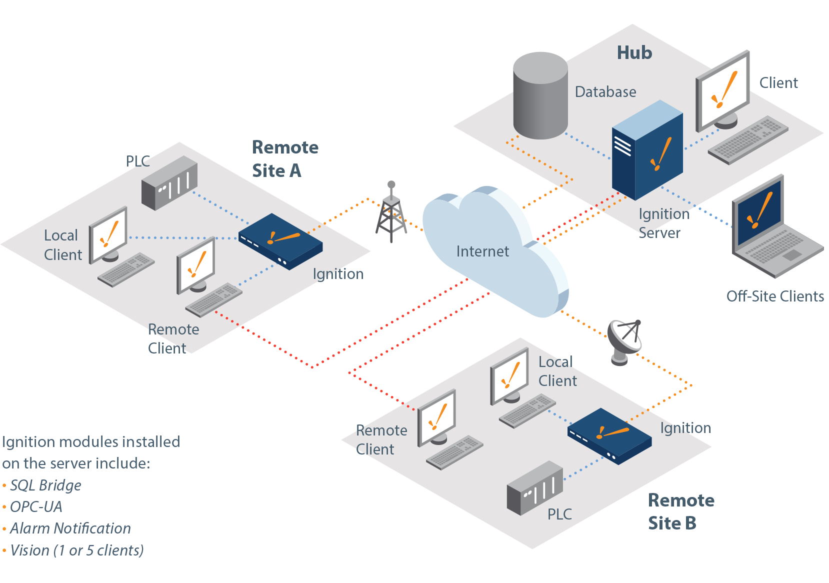

Although the remote data will be saved when the Internet connection goes down, the hub won’t be able to see the remote site when that happens. If your organization needs to maintain visibility to your projects when the connection goes down, you can add a local Ignition client with a limited version of the Vision Module at the remote sites. That way, the remote clients can fall back to their local client and keep the project visible when the connection to the hub is lost. For water districts or oil-and-gas companies with remote sites that need to function when the connection to the hub is down, this hub-and-spoke architecture with local client fallbacks and local and remote logging is ideal.
Organizations can continue strengthening the spokes in their architecture by adding alarming to them. This can be accomplished by adding the Alarm Notification Module to each of the remote sites.
With hub-and-spoke architectures, you can keep your remote sites fairly limited or make them more independent by adding more modules and local clients to them. You have the option of simply logging data from many sites centrally, or of setting up remote sites that are able to keep performing many critical functions on their own.
Hub & Spoke with Vision & Alarming
Hub & Spoke with Vision and Alarming
Handle alarms centrally, or at each remote site.

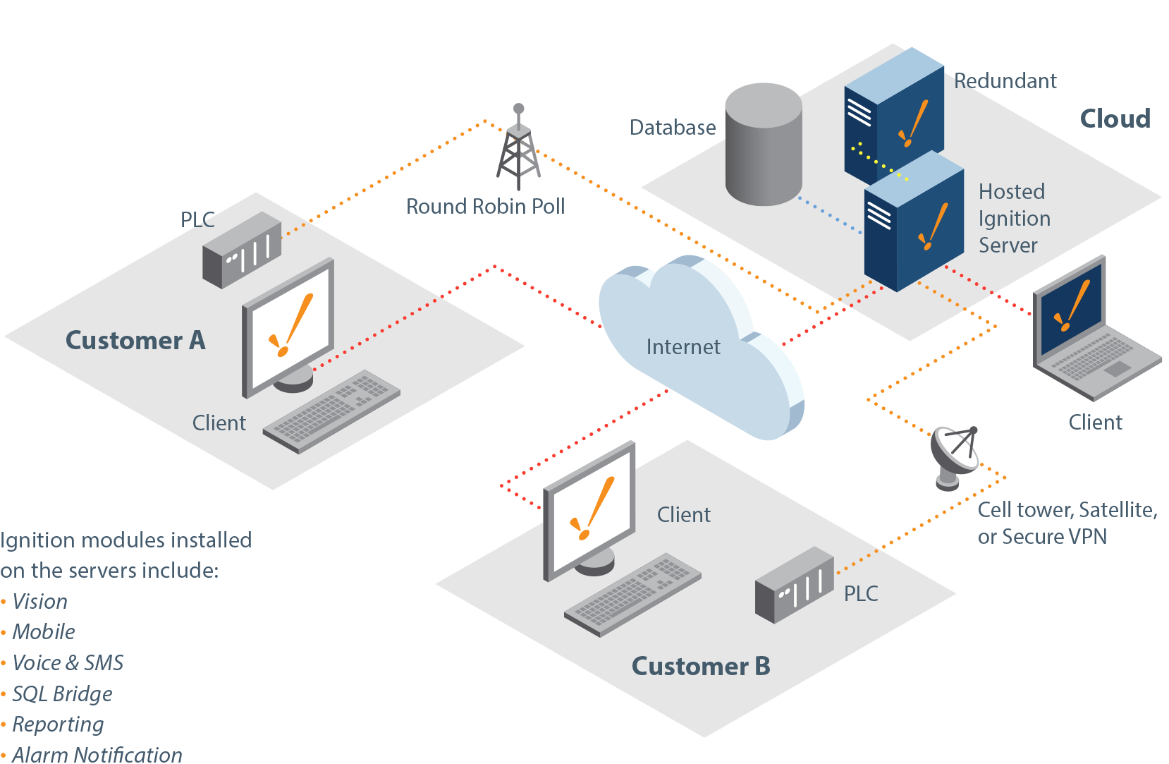

Hosted Ignition Server
Cloud hosting.
Ignition can also be used in a hosted environment using the Cloud. This software-as-a-service (SaaS) approach is becoming more popular among end users and system integrators. Cloud-based systems offer several appealing benefits including simple scalability, easy data access via the Internet, and lower IT costs.
So how does a Cloud-based Ignition architecture work? The general strategy is for the integrator to host Ignition on their own servers or through a Cloud-computing service (such as Amazon Web Services, Microsoft Azure, or Rackspace) to provide runtime clients for their customers. The integrator would set up two redundant Ignition servers in the Cloud along with a firewall and a public IP address. The customer’s information would be collected in the Cloud, and then the customer could open up a runtime client and log in from almost anywhere to see their screens, reports, trends, and any other features that are being provided on the Ignition Cloud server.
In order to host the customer’s information, the integrator needs to collect it from the customer’s PLCs. A smart way to do this is to install Ignition with the SQL Bridge Module at each of the customer sites, so that their data can be logged to the database in the central location hosted by the integrator. The other way to collect the information would be to connect the Cloud server directly to the PLCs through a cell tower, a satellite, a secure VPN, or by polling or round-robin-type polling, although this method could cause security concerns for some customers.
Cloud computing is possible with Ignition, but those who deploy such an architecture should be careful about what they put in the Cloud. It is best not to handle control in the Cloud, so that you do not create the possibility that someone to could turn parts of your system on and off from the Internet.
