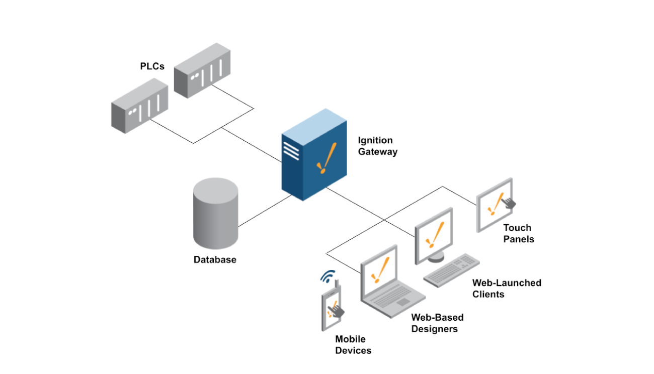

Basic system architecture
Starting With The Basics
If you’re just beginning with Ignition, a basic architecture using a single Ignition gateway is often the best place to start. This approach works well for smaller facilities with stable networks and moderate demands. In this model, one server handles everything, including device communication, client connections, SQL interactions, tag processing, alarms, historical data, and more.
This centralized architecture is cost-effective, easy to maintain, and scales well within certain thresholds. Many organizations can support up to 100 clients, 100 devices, and 150,000 tags before they may have to consider a larger deployment.

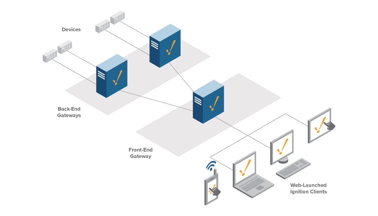

Scale out architecture
When To Switch To A Scale-Out Architecture
As your system grows, so do the demands on your server’s CPU and memory. There is no one-size-fits-all solution for server sizing. Server performance depends on a few key variables, including but not limited to the number of tags, tag change rate, number of clients, polling frequency, scripting usage, and overall system complexity.
As a general rule, small systems can run on about two cores and four GB RAM, medium systems benefit from four or more cores and 8-16 GB RAM, and large systems typically require 8-16 or more cores and 32-64 GB RAM and may need to be scaled across multiple VMs. To get a deeper understanding of what your system may need, you can also perform load testing and check out resources like the Ignition Server Sizing and Architecture Guide.
When it’s finally time to expand your system, that’s when you should consider a scale-out architecture. This architecture separates the frontend (clients) and backend (devices and data processing) gateways so you can balance workloads more efficiently.
A scale-out architecture can be especially helpful when real-time responsiveness is critical and data loads are too much for a single system to handle reliably. One gateway might focus entirely on real-time data acquisition and alarming, while another handles Perspective sessions and the project logic behind your application, such as event scripts, database queries, tag change handlers, and automation logic. Separating these responsibilities ensures that your system performs more smoothly and is easier to tune.

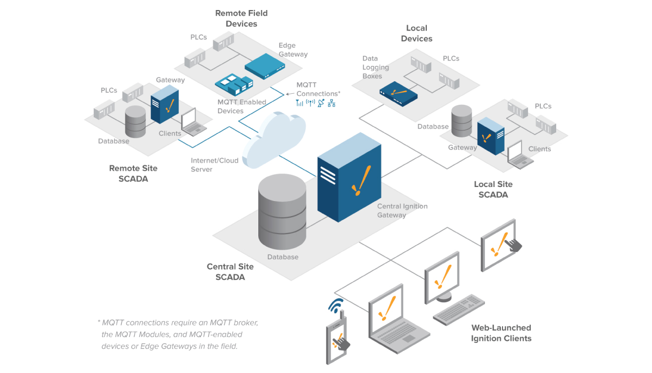

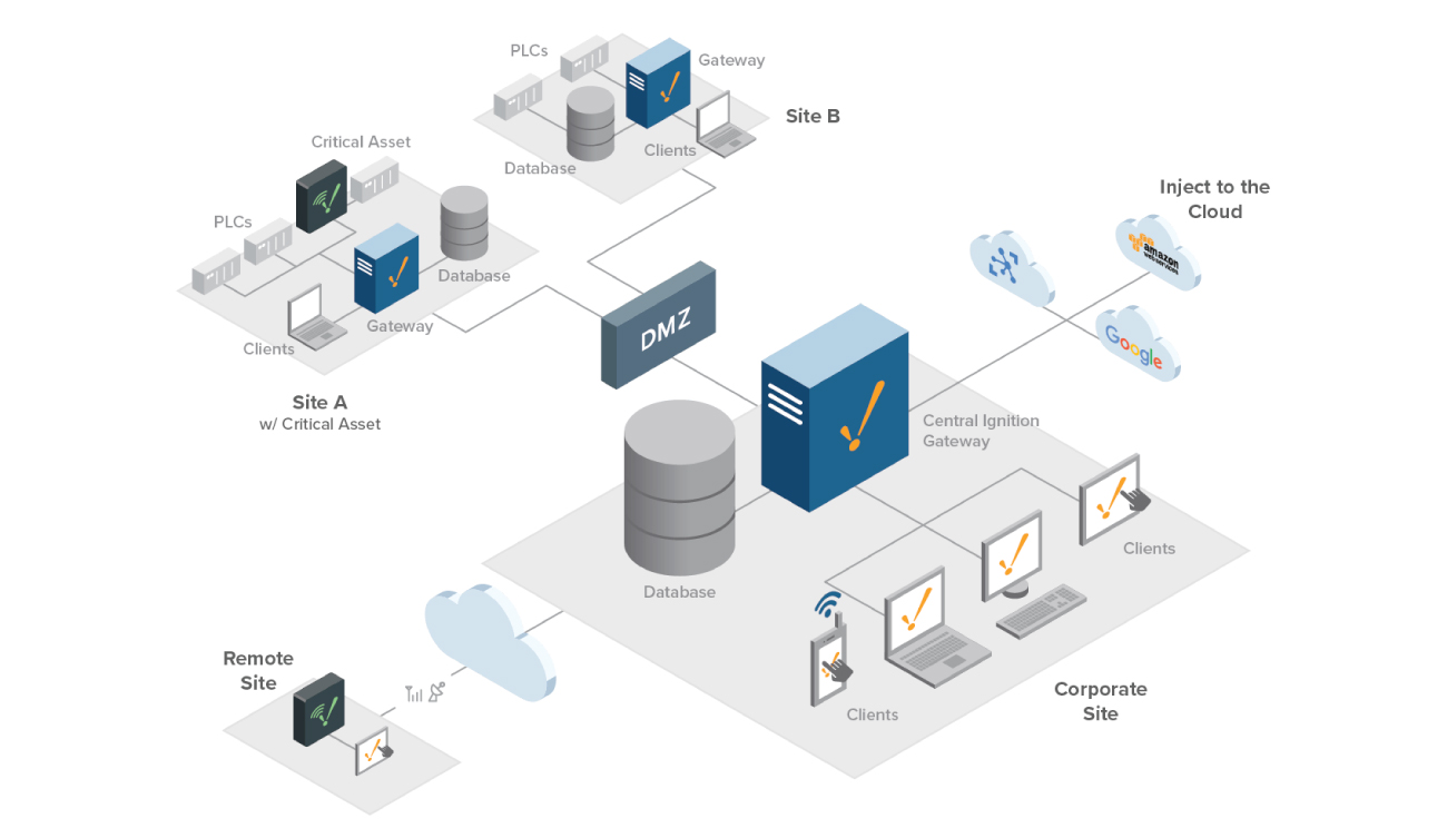

Enterprise architecture
Centralize Disparate Systems With The Enterprise Architecture
As your business scales across new sites and larger regions, an enterprise architecture becomes essential. Each independent local site and remote site operates its own Ignition gateway or gateways but sends contextualized and standardized data up to a central corporate gateway and its cloud services. This allows for enterprise-wide KPIs, unified dashboards, and seamless integration with MES, enterprise resource planning (ERP), BI, and cloud computing tools.
Following the ISA-95 or Purdue Model, you can isolate the control, operations, and enterprise layers and protect the connection with a DMZ. Each level is independently secured and optimized while maintaining clean data flow from the plant floor to executive dashboards.

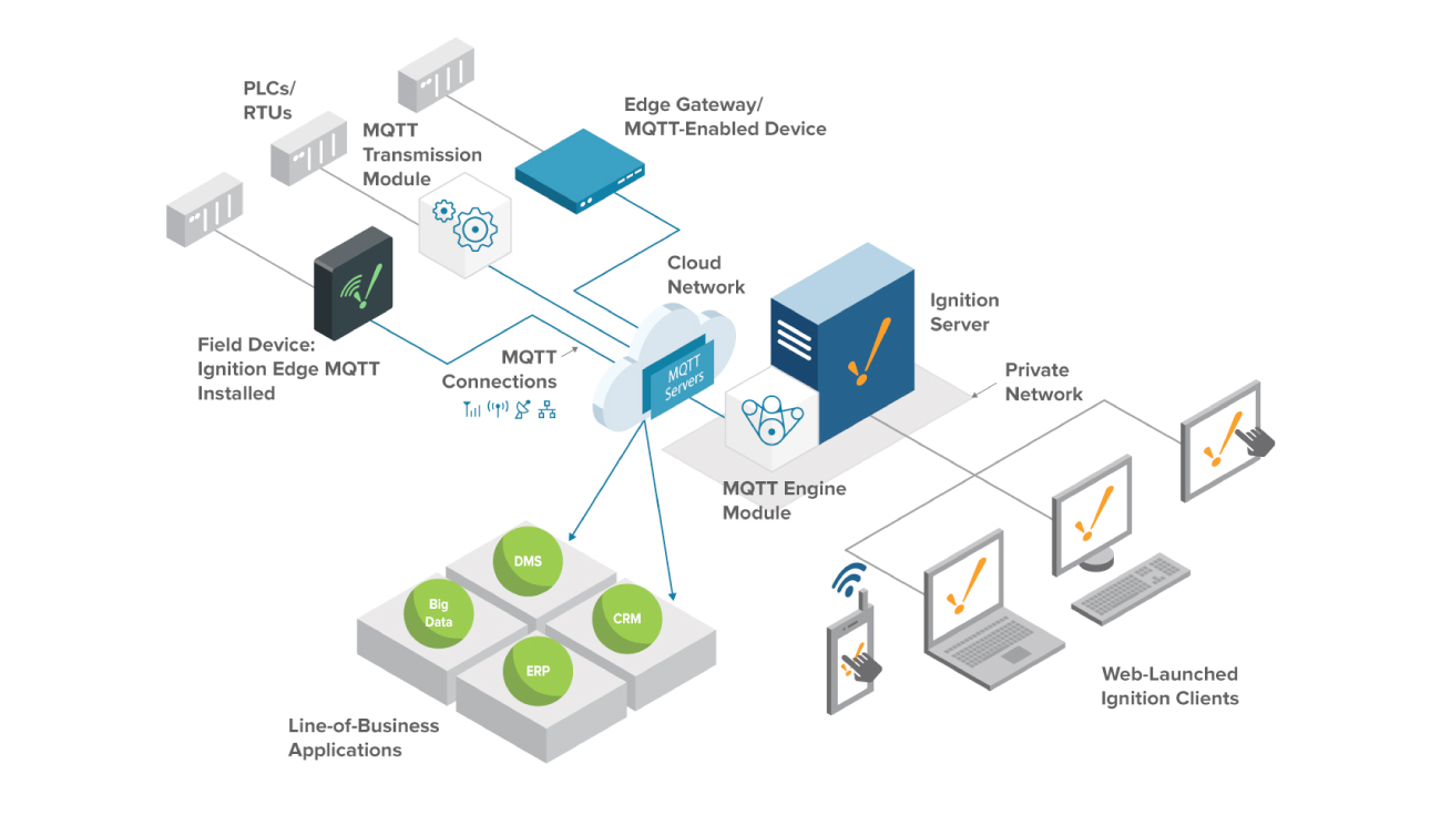

Modern IIoT architecture
IIoT Architecture With MQTT And A Unified Namespace (UNS)
While the gateway network is great for connecting Ignition systems, MQTT introduces a publish/subscribe model that allows for even more scalable, decoupled architectures. Using MQTT and the UNS model, you can publish contextualized data from field devices or gateways into a centralized broker. This enables other systems to subscribe to whatever data they need.
MQTT is particularly useful when you want to enable interoperability across systems, reduce network traffic and bandwidth, or scale with minimal disruption. MQTT has rapidly become a leading standard for modern IIoT architectures because it facilitates efficient, secure data transport; has store-and-forward and plug-and-play capabilities; and integrates well with modern technologies.

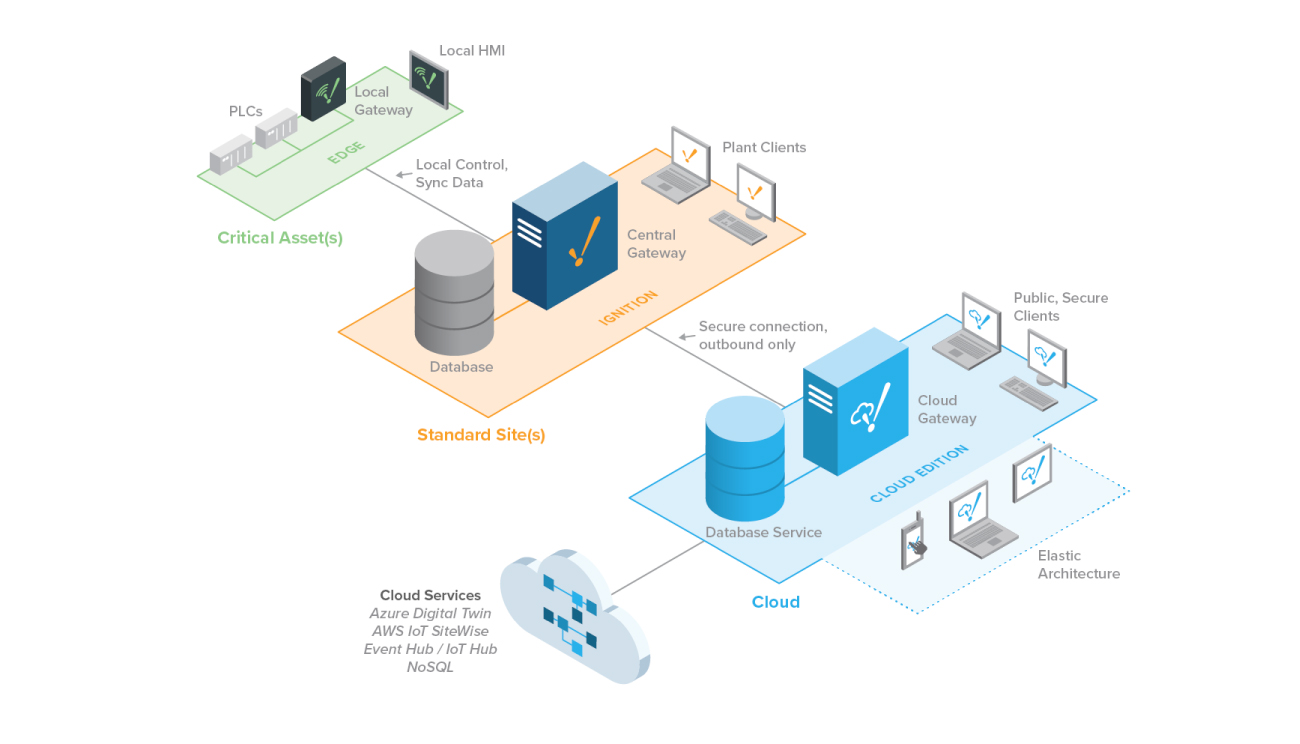

Hybrid architecture
Bridging On-Premise & Cloud Systems With A Hybrid Architecture
For organizations that embrace a cloud infrastructure or are looking to centralize operations while retaining on-premise control, Ignition also supports hybrid deployments. You can run gateways in the cloud or on the edge, with MQTT acting as the bridge. This lets you collect on-site data securely while leveraging cloud storage, analytics, or remote dashboards. It's a powerful option for remote monitoring, scalability, and enterprise-wide data visibility without needing to rip and replace existing systems.
